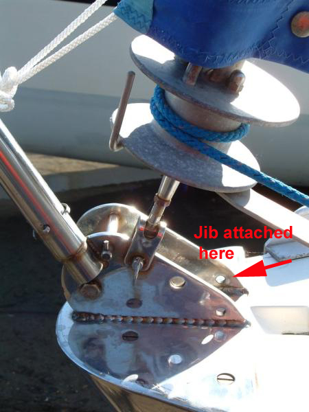

Hi, yes - I am. I attach the Clew of the sail to the starboard side of the bow-roller and have a second halyard rove through a block just below the forestay mounting. I also mounted sliders on the coach-roof to give some adjustment if necessary. I'm using a rope halyard at present led back to one of the winches but as initial trials have worked well so I'll probably go the whole hog and have a wire halyard and Highfield lever to get the tension right.
The bow fitting is tight with the existing headsail furler very close but there is just enough room. I did consider taking a short wire strop down inside the anchor well and modifying the 'U' bolt mounting of the recovery ring to take the load but ultimately didn't have to. Its another option. I'll take photos if you want them.

Hi, The jib is attached at the clew by a single twisted (90) shackle. I already had a sheave in the mast so just rove a 6mm pre-stretched multiplat line through it which then comes through the mast and exits about a foot above the deck and then via blocks to the winch. When I fit the wire halyard I intend to fit a highfield lever at the base of the mast.
