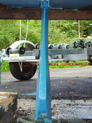

What type of keel do you have,?as some of the boats had an earlier type.your keel sould have a thick leading edge,increasing to thebase of the keel, so when down you have maximum stability,and when wound up, the thick leading edge,gives an extra bit of stability over a normal keel shape(aerofoil shape)some of the earlier swifts did have a few problems as the boats were on swinging moorings and with the keel up ,the centre of gravity came up too!!!add a nice tall mast,25foot plus and some strong windsand sea,you could have a problem.!! REGARDS MIKE IN WET AND COLD NORFOLK!!
Post by Terry » Tue Nov 13, 2007 4:24 pm
I never thought of that! This is what the keel you describe looks like, by the way.
