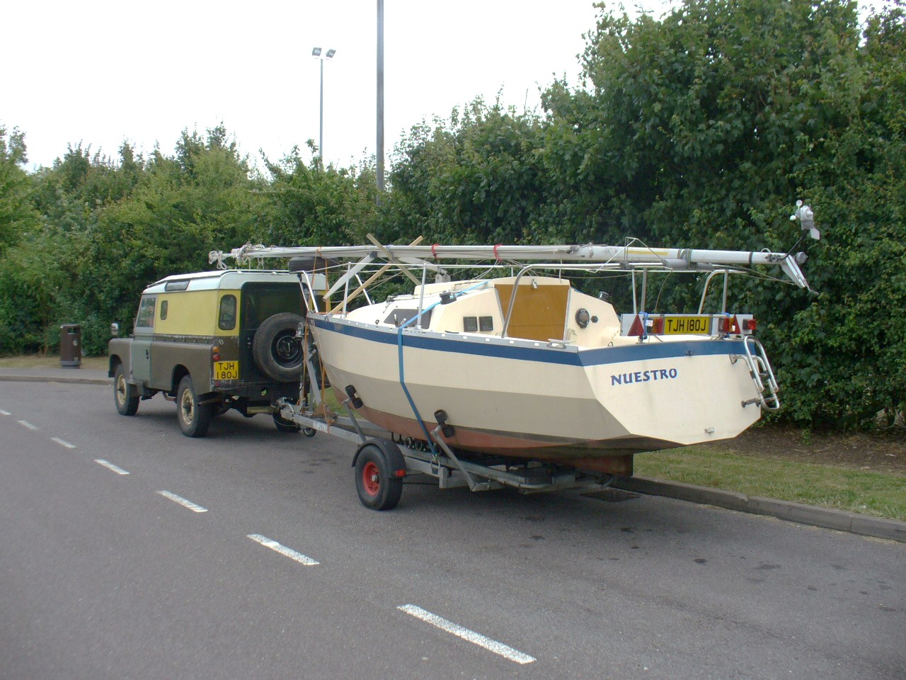

I have towed mine behind a land rover (similar height as T4 – 2m) without issue. I placed a spare wheel on the pulpit (maybe you can add a couple of buoys) with the mast on top so that this oversailed the top of the safari hardtop. Over hang ws ok. See pic.
Philip

Thank you Philip, Your photo is very helpful since I can use it to have a better idea of the height the mast will need to be raised; our camper van is a Fiat Ducato. The spare wheel is a simple solution but I think I would have to raise the mast too high for us. We have a very large and long buoy, we call Bertha from our last boat and this could be a good way of getting more height so I will take this on board too! We will be towing in the UK and it seems we may have to go a long way to find our new boat – we live in the West Country.
Regards
Peter
