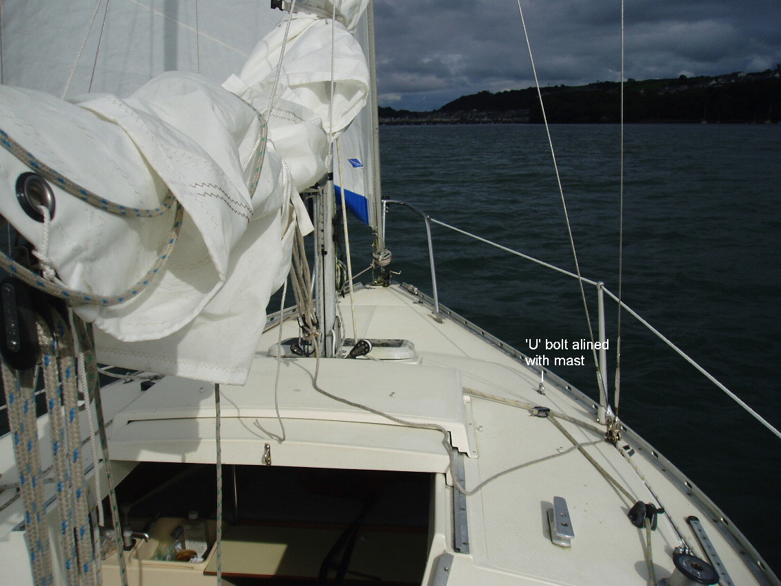

On my boat there are 2 ‘U’ boats either side of the mast and I’ve often wondered what they were for. I noticed the same bolts on Simon’s boat ‘Arabesque’ and he said he thought they were for fixing a purpose built ‘A’ frame to. Looking at the gallery, on the few boats that show the area concerned, I can’t see them. Do many other boats have these bolts and do their owners have different ideas about what there used for?

Terry,
On our boat Windsong, these U bolts are either side of the mast but slightly
further aft. Ours were used by a previous owner to attach blocks for Storm
Jib sheets to be led back to the cockpit. Can you supply a photo to confirm
Cheers
Steve

Post by Terry » Mon Sep 17, 2007 10:33 am
Will do at the next opportunity, The weathers a bit wild up here at the moment and I'm working so it might be a week or so before I can get back on board. If fact next time I do it will probably be to bring Seren home for the season. (boo hoo)

Post by Terry » Sat Sep 22, 2007 11:57 pm
Steve
Picture of 'U' bolt position as promised
