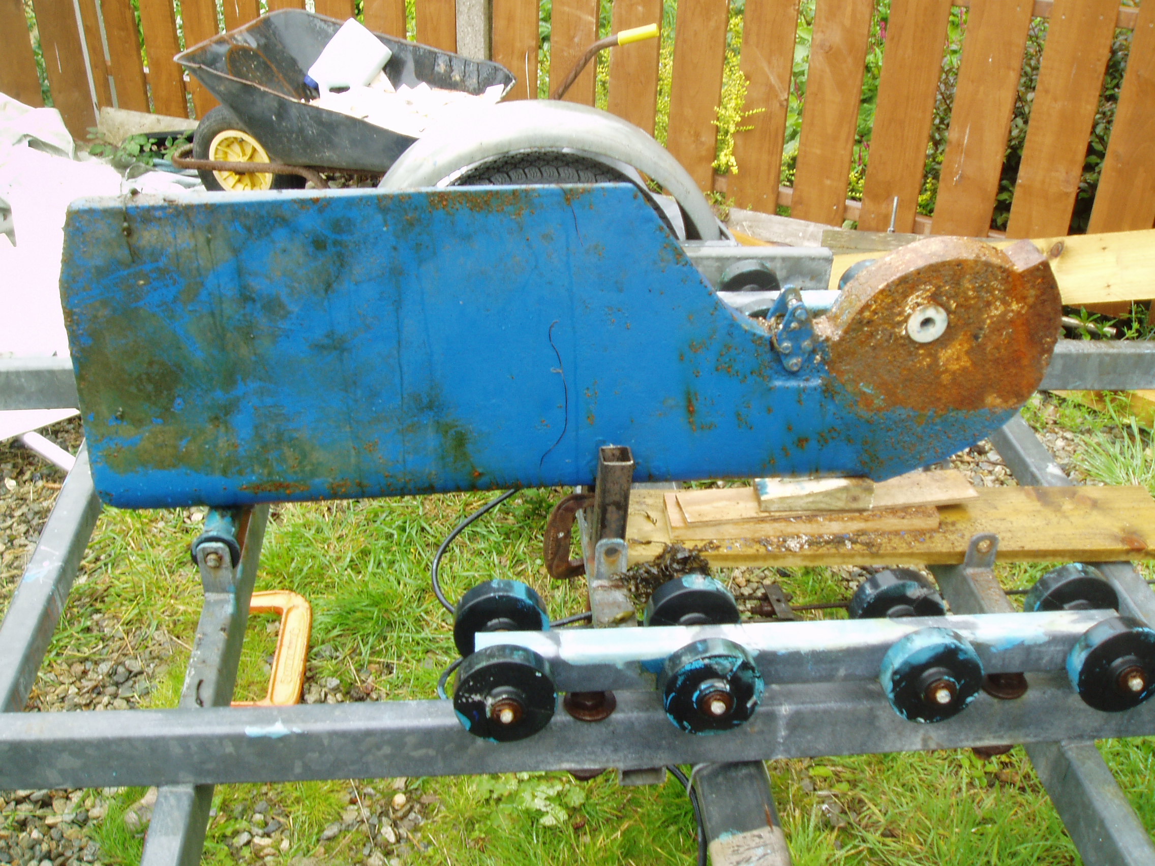

Following a good early start to the season Seren has had to come out for some serious maintenance. After getting a small amount of water on the cabin soul, whenever we heel too far, I put the problem down to rubber keel bolt washers. Replacing them, if anything, just made matters worse. Then I spotted some cracking around the keel box and wondered if I was tightening the bolt too much. I dried Seren out on a sand bank and set to work gunging things up with epoxy and covered the lot with Sikafex. No affect at all! Also, I have water in the foam between the floor and the deck
I’ve now got the keel off at home and have managed to get most of the water out of the foam sandwich. I’ll scrape of the antifouling and have a good look at the join between the hull and keel box when it stops raining.

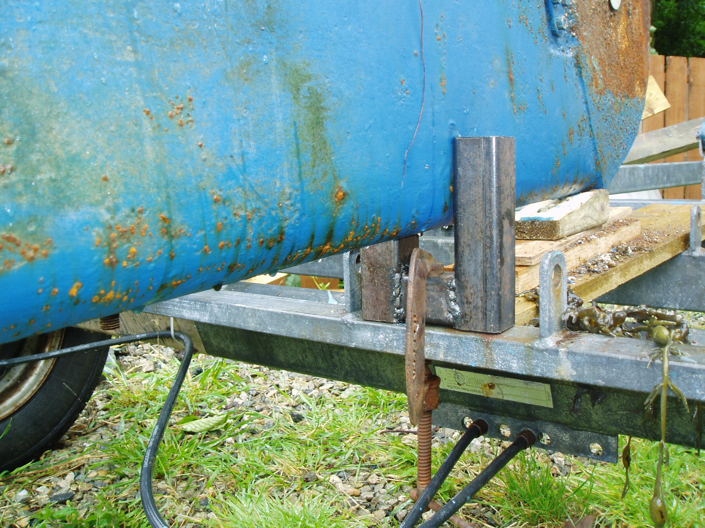

The method I used to remove the keel was to secure it to the trailer using a small metal crotch 2” wide which would prevent it moving when the boat was lifted clear. Then, with the winder fully up, remover the keel bolt and fully back off the winder, jack up the boat and remove the winder mechanism from the keel as soon as the nuts became exposed. Finally, roll the trailer and keel, together, free of the boat, Easy! The idea is to put it back the same way, Easy?

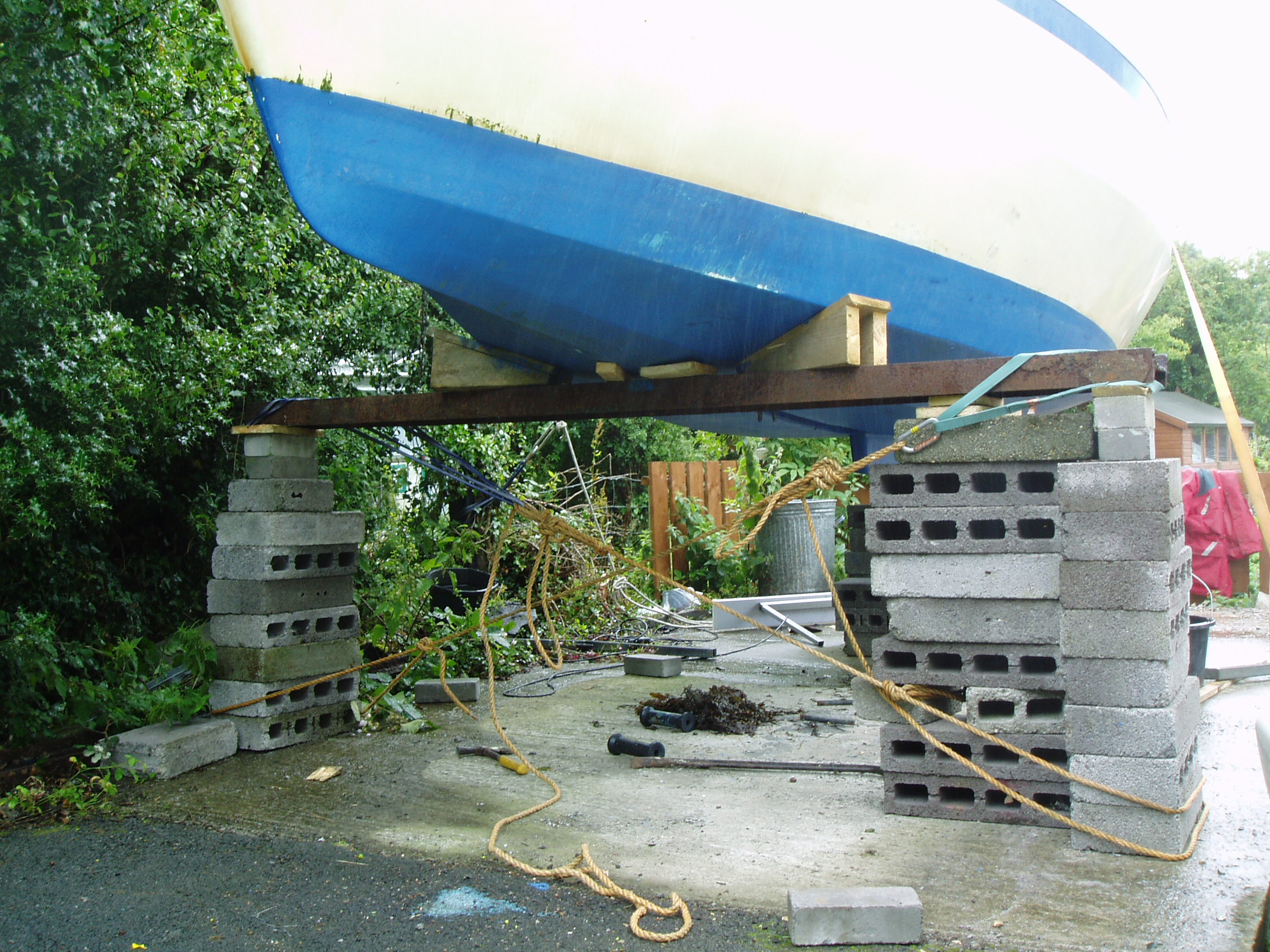

Blimey! Rather you than me Terry, I would be sure to drop it. Good luck with  the repair.

Hi Pauline, You'll be pleased to know that Seren's safely back down on her trailer. The pile of wobbly bricks was actually a bit more stable than it looked but it was still a bit scary. I did some repairs but nothing that I could say that was definitely the problem. I pushed the keel box with a car jack placed between the stove platform and the box, and the same on the other side but couldn't find any cracks between it and the hull. One thing I am sure of is that the hull does'nt leak now.
