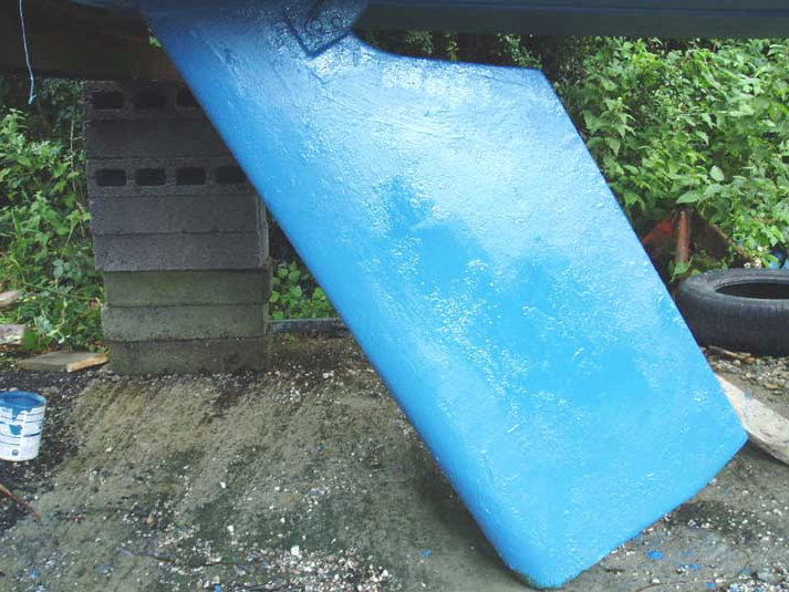

For the past three years I've used a trolly jack, some RSJ's and a teetering pile of concrete blocks to raise Seren up to do the keel but you need to be brave!
You can just about see the set up in the attached pic

I had to have mine done in the boat yard. One important thing to remember is to get maximum coverage of your keel you will need to antifoul it with the keel both up and down. There is a small area at the top that is very hard to get too.
I have added a picture called Keel Up in Wickeds photo gallery that shows what I mean.
