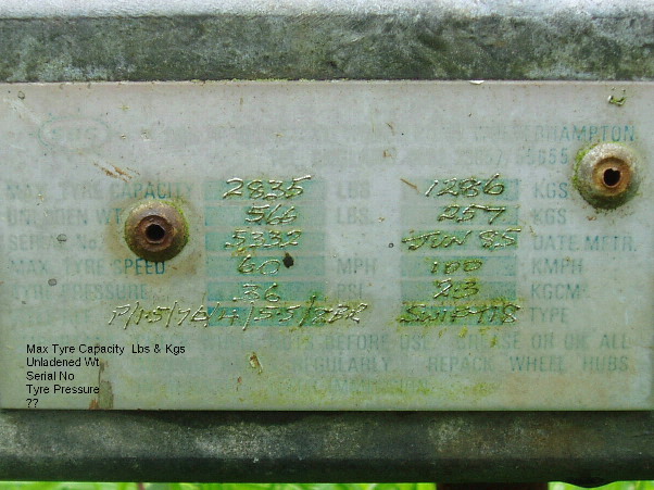

Post by Terry » Fri May 25, 2007 10:03 pm
My original SBS trailer plate gives a max tyre capacity weight of 1286kg and has an unladened weight of 257kg which I suppose means it has a max carrying capacity of about 1000kgs (I think thats right) I replaced the comlete axle, brakes and tow hitch for about £300 (found a tow hitch in a skip which needed a new damper at £48 but otherwise OK). I did it myself and it wasn't a big job. I also put the lot on a weigh bridge and it came in at 1140kgs.
