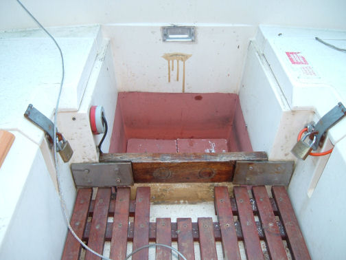

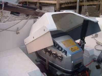

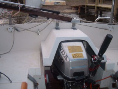

I have a Honda 5HP on Vega (191) the transom has been raised & the cover as well. There is a small recess in the back of the well to clear the engine, all done by a previous owner. I posted some pics on the old Yahoo group, but they are not there now so here they are again.
Rob

I'm curious what are the bits of cable coming out of the cockpit lockers? It looks like the port hand cable might be the charging circuit from the outboard but it looks as if it's looped to something else when the motor isn't there? Just wondering how you have it arranged as i'm considering whether to hook up the charging circuit on my yamaha 4hp.
And is that a black cable - or drain pipe - coming out of the other locker?
many thanks,
martin

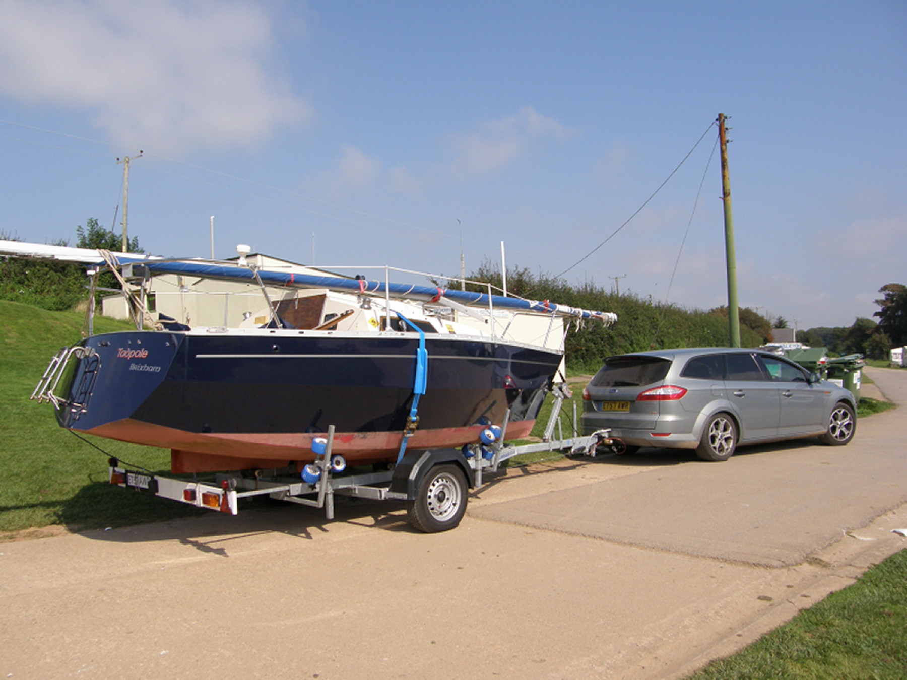

I have attached a pic of the boat the day I got her in September. Can't wait till next year to give her a go.
I am going to raise the transom because I am going to sail her around the Salcombe area and want to get close in to the beach.

Martin
The cable on the port side is as you guessed the charging lead, just tucked back into the locker to keep the plug dry in the picture. The black cable on the starboard side is for the log/depth sender, mounted on the back of the skeg.

Your new Swift looks good in the picture, unusual colour for a Swift, is that blue gel coat? Hope she brings you lots of pleasure when you get her bum wet next year!!!
Rob
helenandpete
Posts: 23
Joined: Sun Oct 12, 2008 9:02 pm
Location: Warwickshire
Post by helenandpete » Fri Nov 14, 2008 7:03 pm
Rob
No its not the gel coat but the last owners had her refinished using International 'Oxford Blue'
She looks good as the boat yard did a great job getting a very high gloss result.
