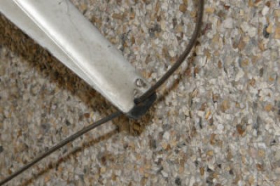

Does anyone have any pictures of the fitting that is used to secure the shroud to the end of the spreader. My spreaders have a small slot for the wire to fit into and then a small hole directly behind. I discovered that the previous owner had used some very narrow gauge wire using the little hole to secure the shroud to the end of the spreader and then covered in tape. I had to remove the tape and wire so that I could replace the rigging but wanted to do the job right. Any hints or tips would be helpful.

Hi Andy,
Which mast have you got?
Mine is the tapered (Holt?) as supplied with the earlier boats.
There is a plastic fitting in the end of the spreader secured with a self tapper through the small hole, see pic.
I think I would be inclined to make new plugs for the end from hard plastic or aluminium.

Hi Rob, sorry for not getting back to you sooner. I don't have the end fitting that you have. I rang Holts and they told me that it's normal to use Monel Seizing wire. It's then covered with some tape and a spreader boot.
